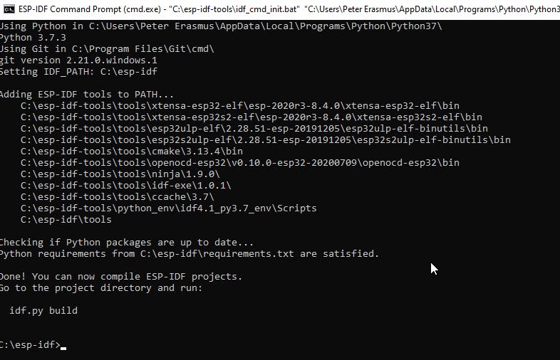

I have 2 win 10 PC's the one I have installed all FC tools and ESP32 running with no issues .
I wanted to do the same on my Programming PC in my LAB FC V9 is running well with AVR and PIC tool chains but the ESP tool chain installed

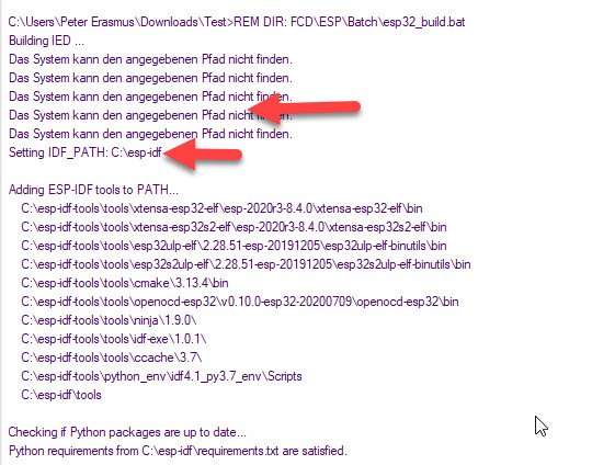

in C\esp-idf as in the working PC the CMD window actually shows that it is setting the path to this location and adding the tools .when
compiling a FC chart FC reports the path C:\esp_idf is not found I just don't understand what could the issue be, Any idea will help :D

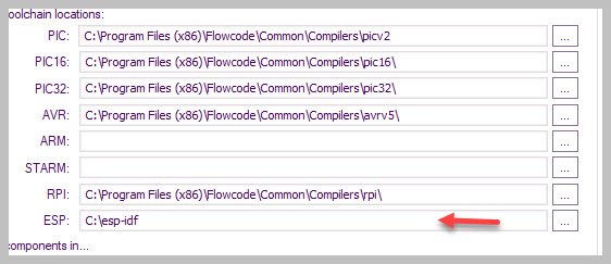

The path is set correctly in FC

CMakeLists.txt not found in project directory c:\users\peter erasmus\downloads\test
This is the problem, spaces are not allowed, unfortunately :(
