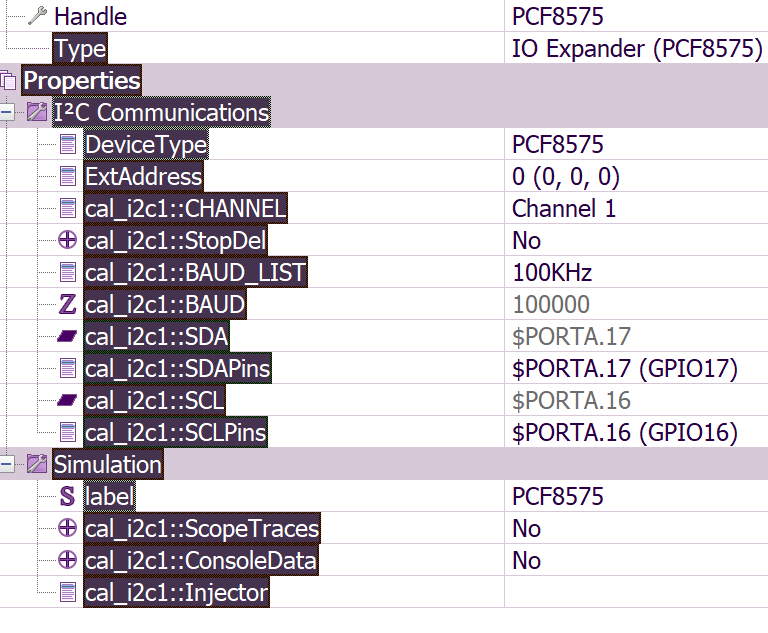

Properties have variable names instead of description?

It might be a configuration setting - but I've noticed that properties seems to get the variable name displayed rather than the description...

Right-click the "properties" heading and select "Show Titles" instead of "Show Variables".

I must have hit the toggle by mistake sometime... Been running like it for weeks too :-)
