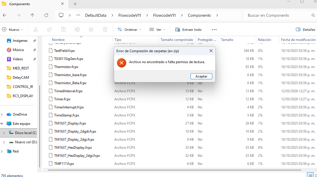

Re: TM1637 4-Digit Display Minor Bug
I tried to copy and paste the file, but I'm getting this error message; I'm using Flowcode 11.
Enrique
Enrique
I was able to save the file in Flowcode 10, but Flowcode 11 wouldn't accept it.

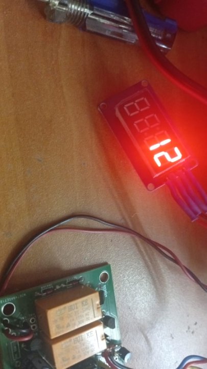

The TM1637 4-digit display component worked in Flowcode 10. Not in Flowcode 11
Saludos
Enrique
Saludos
Enrique
Hello.ELECTRONICA67 wrote: ↑Tue Aug 18, 2026 1:09 amHi
I'm glad it works for Flowcode v10, thanks for letting me know.
It won't be the component since chipfryer27 can successfully add it.
Could it be that Flowcode was open and accessing the original file, so won't allow you to update with a newer version?
Try closing Flowcode v11 then adding component to
%ProgramData%\MatrixTSL\FlowcodeV11\ComponentsMartin
