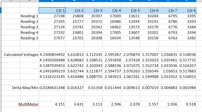

As mentioned my chart is raw manipulation of pins using FC and my PIC is only running at 32MHz (plenty good enough for testing) so speed will never approach anything like I want, but that's OK for now. In my test my clock pin goes high for a predefined period and half way through I read my input. With a clock pulse of roughly 2uS I could easily and reliably pulse out the readings. Remember that I am pulsing all eight channels sequentially so I need to pulse in 128 bits (8 x 16) which is time consuming.
I took five readings and documented.
ADC Readings.png (45.13 KiB) Viewed 31 times
As you can see from the above when compared to the readings taken with my multimeter it seems to be reasonably accurate given my basic test set up.

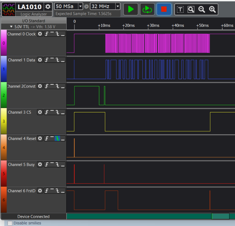

Below are traces from my analyser
The important sequence is as roughly follows:-
Reset goes low, subsequently Convst is taken low and then high which signals to start sampling. Busy goes High at this point too. We do nothing until Busy returns low indicating sampling complete and this then takes FrstD high indicating first data channel is ready to be read. CS goes low, Convst is taken low to hold, and we pulse in data. After the first channel has been clocked in FrstD returns to low. After all channels have been read CS return to high.
Very basic, very slow and very much a fun way to spend a Sunday. I emphasise that this is very, very rough and ready, purely for me to get it working, and once I explore a bit more I will start to get rid of unnecessary delays etc.
