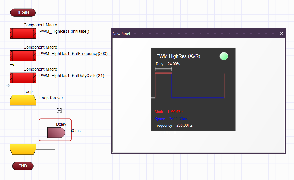

Added simulation.
After replacing the existing component with the attached version, you must reload your project for the changes to work.
Simuation working.png (79.21 KiB) Viewed 4468 times
If you have tried this component, comments would be welcome.

Just tested on a Uno.
Looks good attached to scope and in simulation!
