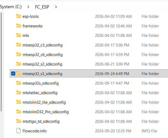

I have two different computers and want to have exactly the same menu configuration settings.

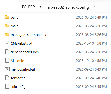

Should I delete the entire mtxesp32_s3_sdconfig folder on one computer and copy it from the other, or is there another way?
this folder:
or files.

After editing the file using idf.py menuconfig - can you just copy the sdkconfig file from the project directory?
Haven't tested - but if you edit for a 'custom' config it would save doing it twice...

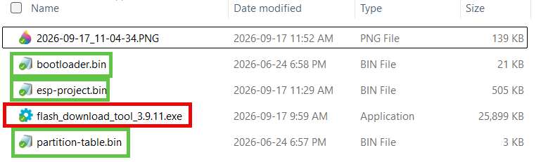

When I'm done with the project, I copy the project file, the bin files and config files right away in a folder.
From there, I can then flash or restore my project.

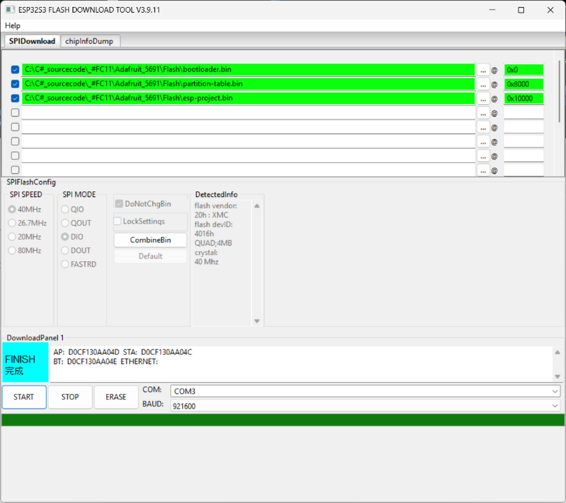

For flash them using a tool (flash_download_tool_3.9.11)
That way, I always have exactly the same program on every new device, and it goes very quickly.
To do this, I use a batch file and then copy `flash_download_tool_3.9.11` into the folder an run it
using in a batchfile:

All the file for flash:
flash_download_tool:
