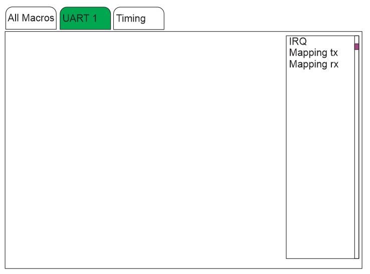

Again I think the drop-down listing of macros is a useful and practical idea. The horizontal tabs should then become redundant and my suggestion is to use these tabs as grouping identifiers for macros, as shown in the drawing I have made.
In the drawing I have selected the UART1 group and the drop down list then shows, for selection, a list of macros within that group.
