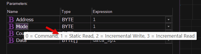

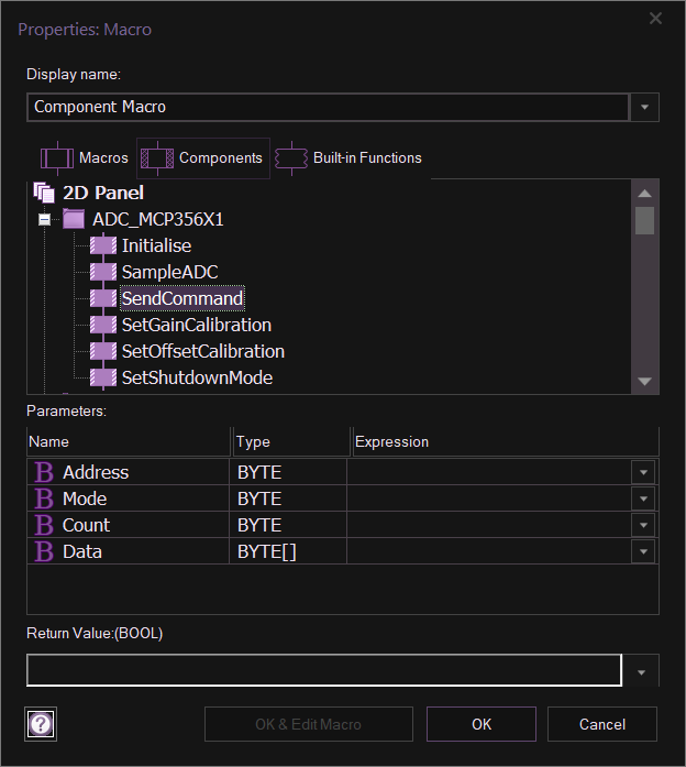

It would be fine with me if the send command worked both ways.
Then I can do everything.

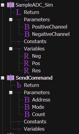

Two questions about the component.
In the finished component, there is a “Data” parameter, but not in the component I downloaded.
Why is the return value BOOL and not BYTE[]?
Parameter in Embeddet: Parameter in component:
