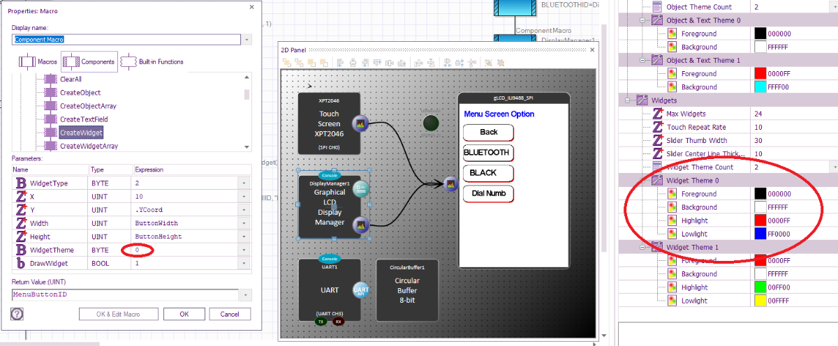

The old project shows the COLORS
The new one doesn't show the COLORS
EDITED
Regarding SECOND POST
So on Saturday I have found the Major BUG that was disrupting the screen when BLANK TOUCH is DETECTED. The issue was whenever time you touch anywhere on the screen other than the buttons. The screen jumps all over the place, sometimes it stop, sometimes I have to reset the esp32...

If you're talking about the buttons not having colours, they look like they are following the defined widget theme.
