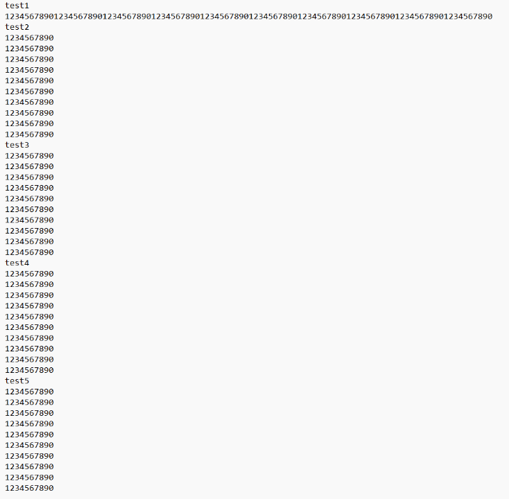

I made a lot of test with the string write to the sd-card (no interrupt)
The test are here: And every test is working fine. PERFECT!

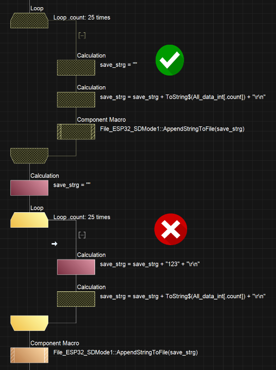

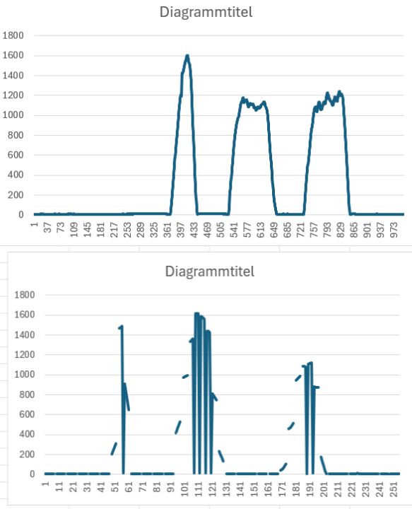

But if I sample and save data, there is a problem with the long string.
On top I save short string 25 times. its ok.
On Botton I save a long string in one go. I get problem even if i use simulate the data but interrupt is on.
The result with short string is perfect.
but with the long string a lot of data is missing or wrong.

I think the problem may be doing the conversion to string inside the concatenate, there is a temporary string created to allow this but it is limited in size to 20 characters by default.
Try doing this instead to work around the problem.
.TempStr = ToString$(All_Data_Int[.count])
Save_Str = Save_Str + .TempStr
Save_Str = Save_Str + "\r\n"

It didn't help, even when I briefly disabled the IRQ.
But 25 short strings work fine.
