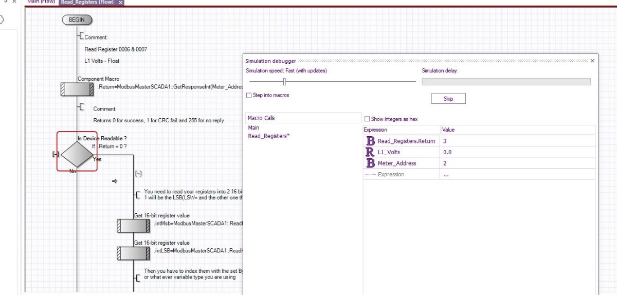

Get Response int. macro is returning a value of 3, what dose this mean ? Can someone please advise

Hi Steve,
GetResponseInt allows you to read an integer from the returned array of data. I would need to see your program to know more.

Thank you ben,
Please Find Attached
Steve
