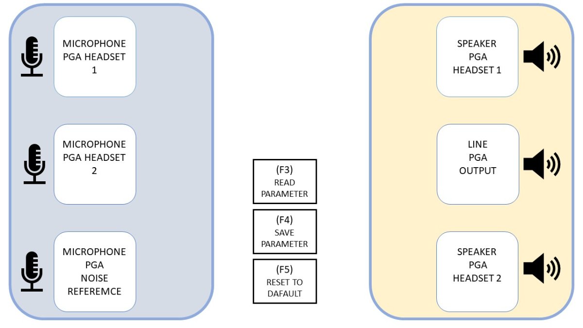

I am making a control panel, and would like to use a background image to help me with the graphics.
In simulation everything is ok, when I go to export the app instead the background image is not exported.

Re: App Developer Background Images
Here you go this seems to be working.
I created a 2D panel object and added the image as a texture and then added the image as a resource during the export to app process.

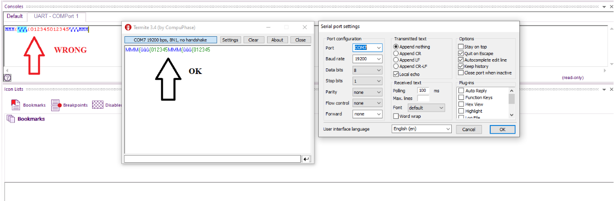

I have a problem with the serial connection between the board and the program. On the one hand I have a pcb with an stm32f031 and an FT234XD converter and on the other hand the windows pc with the application ( app developer). As long as I have to send a single byte all ok, as soon as I try to send an array I have problems.
For example the PC program sends three bytes (0x4D 0x4D, 0x4D). The pcb receives the data correctly and gives the correct answer (0x7B).
At this point the pc program sends 3 bytes again (0xFB, 0xFB, 0xFB) and expects to receive an additional acknowledgment byte (0x7B) and a subsequent 6-byte array containing the values. The pcb sends the confirmation byte (0x7B) but is unable to send the 6 byte array
What can it depend on?
I attach both the app and the program
EDIT
I tried using a terminal and sending the usual commands. with the terminal it seems to work(I tried with termite 3.4)
I am attaching the software configuration through which everything seems to work correctly ( only on termite 3.4)
EDIT

Hi an update on the program.
I was able to get it to work correctly and now the application and the card are talking correctly.
in What was I wrong?
How did I manage the incoming data from the com. Following jay_dee's example I use a temporal interrupt to check the com port buffer.
The com port data is then placed in a circular buffer.
