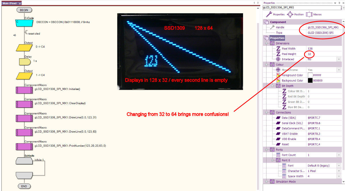

Hello!
I found in other forums, that the component with SSD1306 shall works. I can`t get it running to 100%.
On the attached picture you can see the results. Can you create a component for SSD1309?
Best regards
Jörg

Hello Jorg,
Have you tried changing the interlaced property to yes? Hopefully that's all that's required.

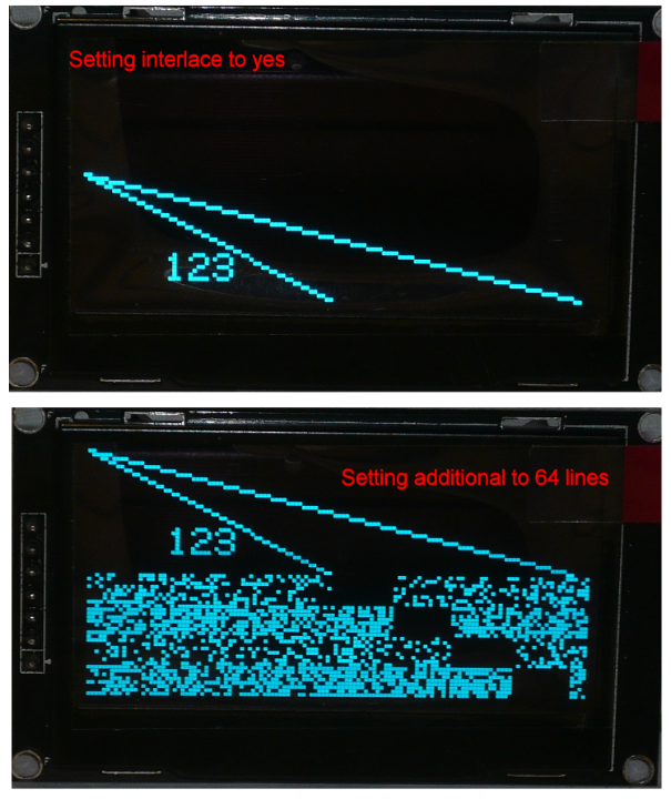

Hello!
I already tried it, but I got no success. The results are in the photos below.
- SSD1309 not working_02.png (777.26 KiB) Viewed 10143 times

I've hopefully tracked down the source of the problem and uploaded a new version to the update system that will shopefully solve the problem for you.

Hello!
I tried the changing and what happens was the following:
Please look at the 2 pictures, I sent before. The text and lines are the same places, but the dummy single pixels from line 33 to 64 are now away!
Thats all.....................
Jörg
Jörg

Thanks Jörg,
I've had another go for you now and hopefully that will be better.

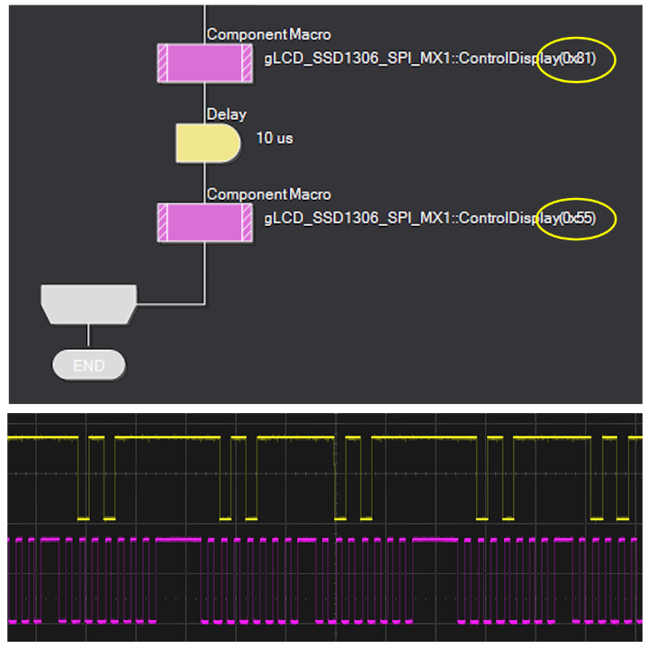

But back to the contrast: My test program writes in a loop 0x81 and 0x55. The pic drives the signals to the display, you can see on the picture.
What happens with the values?
Contrast:
I found under google an entry from a guy who says: There are displays on the market where the step up for the display voltage is done extern on the board and have no connection to the SSD1309 chip. So it is not possibly to adjust the contrast. This may be the reason while my display is not adjustable.
Contrast:
