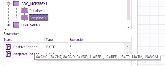

hello
if i set the positive and negative channels to analogue ground, or both to the same ground, the output value should actually be around 0, i think.
the same if i set the selection to 0 and 1 and short circuit the inputs.
is always
16777215<CR><LF>
16776959<CR><LF>
16776703<CR><LF>
16776959<CR><LF>
16776959<CR><LF>
16776703<CR><LF>
16776703<CR><LF>
16777215<CR><LF>
8 and 12 results in
<CR><LF>
16777215<CR><LF>
255<CR><LF>
255<CR><LF>
511<CR><LF>
511<CR><LF>
16777215<CR><LF>
255<CR><LF>
255<CR><LF>
255<CR><LF>
511<CR><LF>
511<CR><LF>
511<CR><LF>
511<CR><LF>
511<CR><LF>
255<CR><LF>
511<CR><LF>
511<CR><LF>
255<CR><LF>
511<CR><LF>
255<CR><LF>
255<CR><LF>
255<CR><LF>
511<CR><LF>
255<CR><LF>
16777215<CR><LF>
please check once

In your program you are sampling between 8 and 12 which equates to GND and REF-. Hopefully this is all that is wrong.
I'm not sure what is suppost to happen here. It could be you are suppost to get 0 but I can't say for sure. What happens if you select a valid ADC input channel for the positive and GND or VREF- as the negative?
