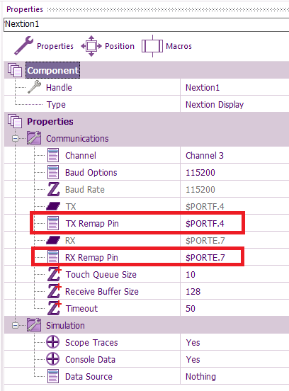

Tried Nextion display on BL0032
Software channel does not appear in channel selection drop down in Properties window
TX and RX pin selections are grayed out so cannot set to any port pins
Can you check and revert

Re: BL0032 NEXTION DISPLAY
Hi David,
Working well for me here using Medelecs fix. Do you have the TX and RX remap pin properties?
No software mode available I'm afraid as we are using the hardware receive interrupt inside the component to collect replies and touch data.
Hi Medelec / Ben
Installed the updated file and can now select port pins fine
And Ben i note your comment re no software mode available makes sense
Many thanks for your joint prompt replies
Best Regards
David
Best Regards
