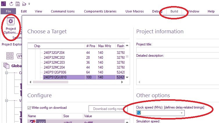

For delay times to be correct, you need to change the clock speed setting for the project,
this should now be x8 (for the PLL multiplier)
