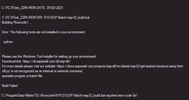

Hi to All
I have on a (new) pc the same problem
I used
esp-idf-tools-setup-offline-2.10
The instalation was without an error
But it cant fount the Python
I used

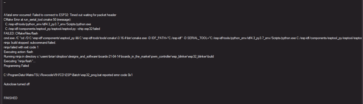

As I'm very new to this esp32 I have now compiled a simple blinker app to try get every thing going but it fails i'm not sure if it could be the board rate which is set at 115200 i'm not sure where i can change this to check

Hi, Brian.
That looks like a communication issue between your PC and ESP32board.
Have you checked within the device manager to see if your board can be seen within the Ports (COM & LPT) section?
With some boards I have, there was a need to press the reset button on the board before it would program.
Have you selected the ESP32 Programmer Port within project options?

Hi, guys
Thanks for all the help I now have a blinking board so we up and running, the reason that it was not communicating is that i had a bridge on the development board pulling RX down just one question do i need to put the C code with OSCCON=0x50; in the beginning of my esp32 projects? and another thing do I set the clock speed in project options to 240Mhz or 40Mhz

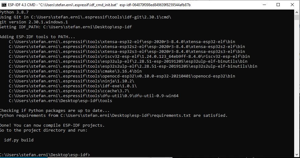

Hi to All
On my computer it's working after I started the following batch file (again)
Desktop\esp-idf\install.bat
@jollybv I hope you have a lot of fun with the ESP32 like me. Together with the Appdevelopper you have so many options to connect and use the ESP32.

Re: ESP32 Compiling error
On a second computer I have again this Python is not installed problem even the test give a OK.
In this computer it does not help to run the install.bat again
C:\ProgramData\MatrixTSL\FlowcodeV9\FCD\ESP\Batch\esp32_build.bat "C:\esp-idf\" "test_install" "C:\FC9_esp32\4install\" esp32s_sdkconfig
C:\FC9_esp32\4install>REM CRC: 0796FC1E6A776AF9156B257209C35258CE7C28B3EC20AEA2C632DB392A0E4BFD5B3F53B21811978F7B21FE4085045A7E774D1D3D69D8A99EE7320EAE740A5DB6FE0D8D4660AC0314F98C28BCA92AF856EFD1DB5B777140BC4D00059D795899827D9F76D89626FBC8B199900461C78937B42DEF8219F63A24580137A2F6C8FDB7553324EFF791947E8AB6FFD612B81BAA97C798A8F1CFC189DE5D38517747C774AF2DD6F839BAECF83F7F994C7164CE77868F480396BDEF2F2C3050DA273BE4EE6FE0BB589D1229A5E37B217FF86DBD72A01B8FBC49BE02BFA3608A0B0CE69F969622A912E6E6A2FB
C:\FC9_esp32\4install>REM REVISION: 4.0
C:\FC9_esp32\4install>REM GUID: 955EA920-4961-4C53-BA6B-EF4AF66BB4C2
C:\FC9_esp32\4install>REM DATE: 29\03\2021
C:\FC9_esp32\4install>REM DIR: FCD\ESP\Batch\esp32_build.bat
Building test_install ...
Error: The following tools are not installed in your environment.
python
Please use the Windows Tool installer for setting up your environment.
Download link: https://dl.espressif.com/dl/esp-idf/
For more details please visit our website: https://docs.espressif.com/projects/esp ... setup.html
'idf.py' is not recognized as an internal or external command,
operable program or batch file.
Build Failed
Autoclose turned off
FINISHED
- Ok.JPG (95.6 KiB) Viewed 7310 times

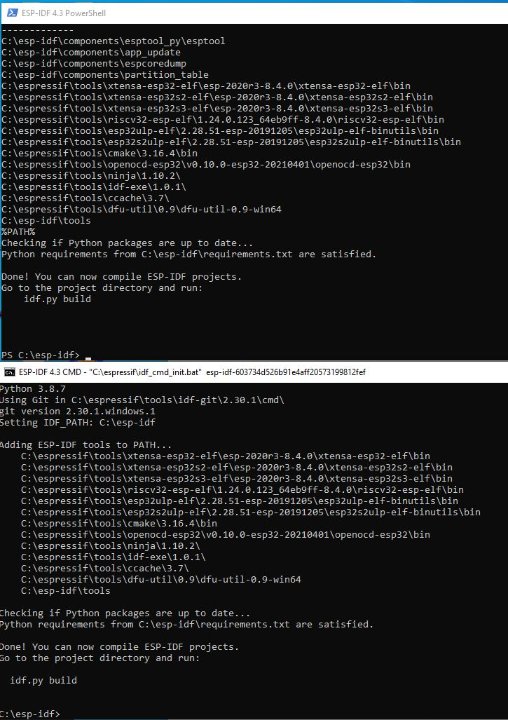

Could you run the ESP-IDF command prompt, then type
export
