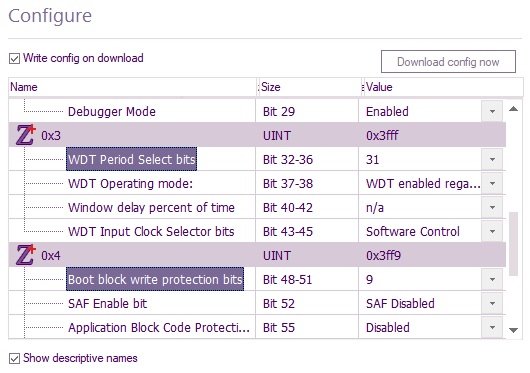

These two settings in your confguration look incorrect, can you check these settings,

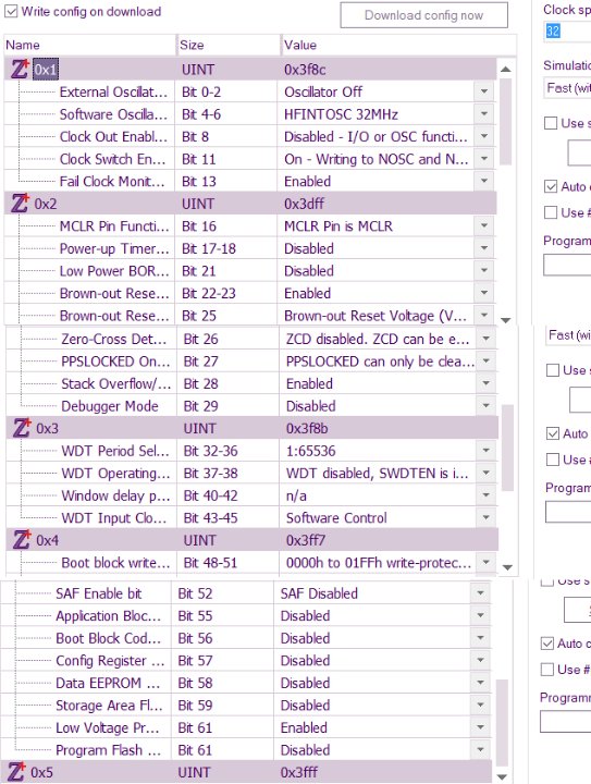

Marc-Lepage-AIF
- Posts: 6
- Joined: Fri Feb 12, 2021 3:29 pm
- Been thanked: 1 time
Re: ADC on 16F18426
Hi Ben , Hi erasmus,
Thank's both ...find here under the correct setting...
