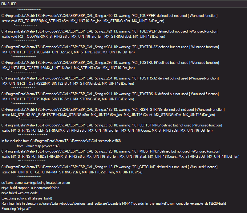

Hi guys
I ordered some probes from china and the ended up being DS18B20, I found the example on wiki but for some reason it will not compile to the esp32, Keep getting warnings and then it fails Could this be something I'm doing or a problem with the 1 wire component?
