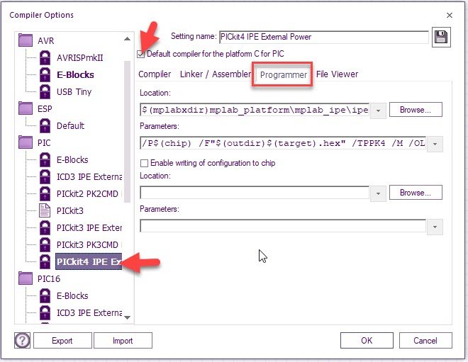

You should be able to select the PicKit4 as a standard option in V9 as you will see below,Note you have to select the check mark set as default.
Another issue could be if you use an MPLAB verion pre-5.30 then the ipe is not in mplab_platform folder you need to search for it then I am not sure where it was located pre 5.30 version it a long time ago.

Peter- thanks for the hint regarding the location for the programmer. once changed to
C:\Program Files\Microchip\MPLABX\v5.50\mplab_platform\mplab_ipe\ipecmd.exe
it downloads fine.
