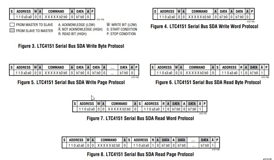

There are 3 ways to work with I2C or for that matter with serial communications
(1) Use Logic Analyser to see what you are writing and reading from the bus
(2) an Oscilliscope with decoder protocols
(3) use a Arduino UNO or any Matrix Scada device with Comms simulation you can see the traces and register values in FC debugger windows
Out of experience I would advise you to follow the LTC I2C protocol exactly otherwise the Device will not ACK the write /read operations and you will not get any responses
can you post your FC chart that the guys can try to help but as said you need some tool to see what you are doing
