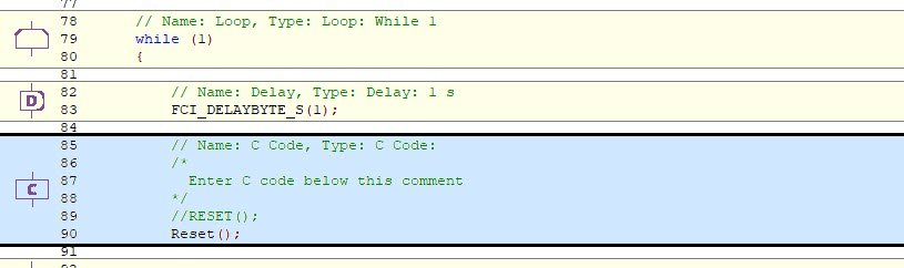

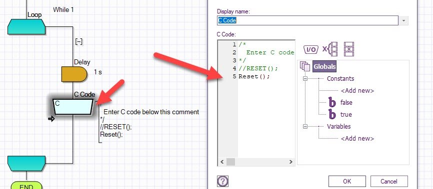

I never used this Reset function on either PIC or AVR however I know the XC8 for PIC has Reset() Macro which can be called.
Calling the reset macro from a C Icon seems to compile fine and is generated in the C code so I would think that it will work
for XC8 it is Reset();
Maybe some one can try it :D :D
