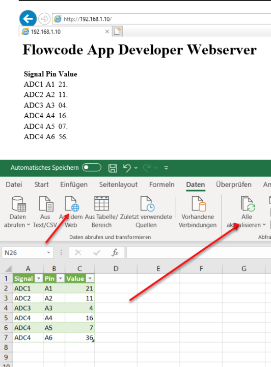

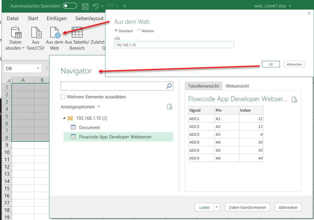

I changed it a little and took the date and time as simulated AD values. I wrote these values in an HTML table. I can look at this table in Explorer and also automatically insert and refresh this table in Excel. I just have to enter the IP address. I would now like to read and process this table with the app developper. How can I do that?
how to choose the webserver for Excel and insert the tabel
App Developper: From Webserver to App Developper

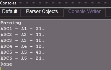

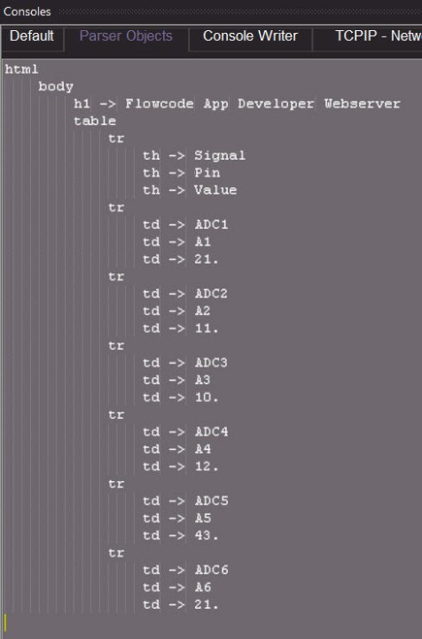

Re: App Developper: From Webserver to App Developper
Yes it does work as is with the XML parser. HTML and XML are very similar.
Here's a simple example to parse the data string and print data to the console.
You would just need to combine this with the example with the GET request and then you will be able to collect the data string from the server and parse through the data table.

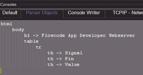

Thanks a lot for the example. I put both together and it looks like it works,
but not enough characters are received. One times it will be 179 or then 19 or 79 or 139. I tried to make all the arrays bigger but without success.

Hi Stefan,
So it's the Network Comms that is receiving not all the data. Maybe try adding a small delay in between issuing the GET command and receiving the data, this will allow the data to be collected and ready when you call the receive function. Maybe try a delay of 1s and see how you get on. If this works well then you can try reducing to see what you can get away with.
Another way might be to receive data and store into a circular buffer char by char, then try and receive more data and repeat until you get a timeout or instead search the CB for the "</html>" tag to indicate the end of the data.
I could maybe add routines to the CB component to allow you to easily store and retrive a string. I'll look into this now for you.

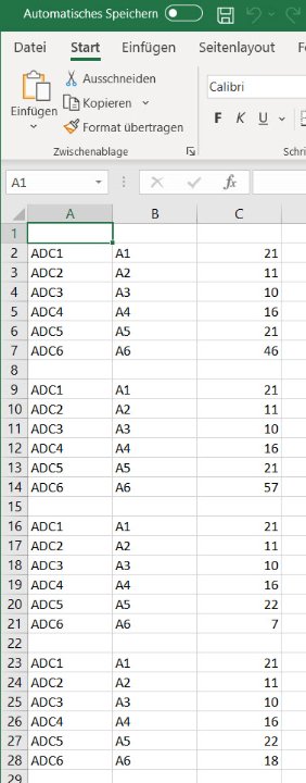

I add the CSV writer and It is very convenient to save an Excel file on the PC with the data from a Flowcode web server
that's always okay with mebut it's not really been well tested yet
