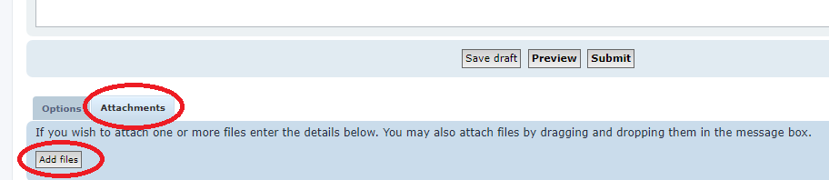

I've tried it again and it's coming up with the same error.
Is there any possibility to attach a document in this forum so you will see the message I'm receiving?
Thanks,
Bachir
LeighM
Posts: 553
Has thanked: 103 times
Been thanked: 302 times
Re: Flowcode not communicating with Hardware
Post by LeighM »
As Steve mentioned ...
If there are any problems during this procedure, they will be displayed in the output text, which is also stored to a file with the suffix ".msg.txt"
Which can be uploaded via the button ...
