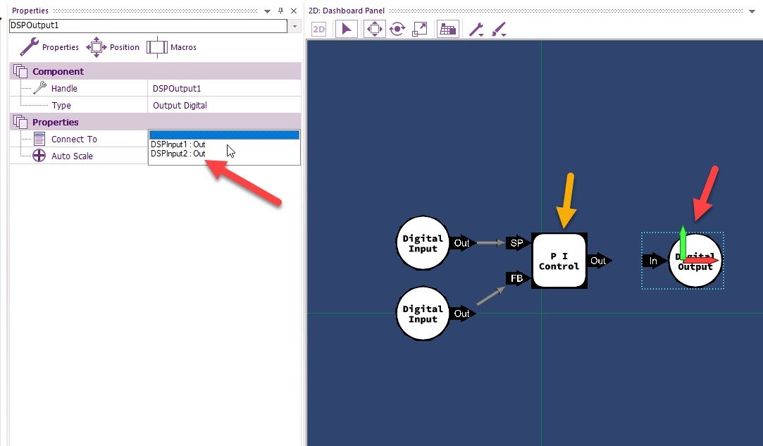

Hello Ben,
I am having issue to get going with the new DSP PI and PID component (used it many times in V7 and V8) :oops:
I have two digital values Setspeed and Actual Speed which is my Set and Feed back signals ( as they come over CAN they are numerical values in RPM)
I connect these two values to the PI Component by a Digital Input icon as below however my issue is how to extract the output from the PI component
I use the Process(macro) but I do not see any way to get the value, I also try to use a Digital output but I cannot connect the Digital output to the PI Components.
What am I doing wrong or do not understand Please help as always it isappreciated

Re: DSP PI Controller
Hi Peter
You have done nothing wrong.
Look here, I think Ben will fix it soon
viewtopic.php?f=5&t=777
Greetings from snowy Switzerland
Sorry about this, hopefully solved for you now.
Post by p.erasmus »
Ben.
Thanks a million the fix work for my situation however Stefan is corrcet there are a couple more that the Digital output cannotconnect too :D
Posts: 2241
Has thanked: 616 times
Been thanked: 814 times
Aha excellent thanks for that they all work here but I delayed pushing them out to the update system to confirm everything was ok and now they are no longer flagged as needing pushing.
I'll get these pushed out for you now.
Post by p.erasmus »
Hi Ben.
Thanks it seems to be all ok now :D
