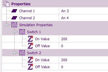

How to be able to use Touch on ESP32 and TTGO-T?
I tried to use EBM013 comp but prog can not be compiled.

That message is a warning. Are there other errors in the compilation output? It might help us if you post your project and the .msg.txt file that lists the compiler output.

I think the ADC touch is not currently supported on the ESP devices. This is reported in line 106 of the msg.txt file.

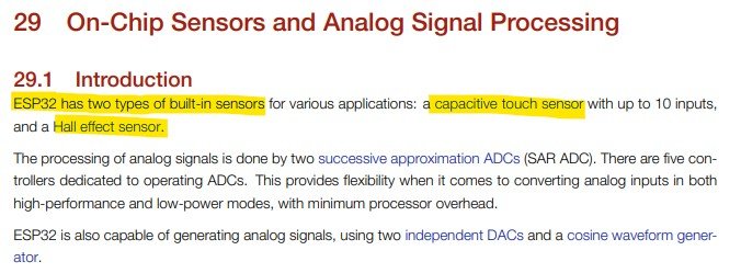

Sorry but all ESP32 has capacitive-sensing GPIOs.

The esp might have it but it’s not supported by flowcode as Steve mentions.

I understand now.
Even if English is not my first language.
So Steve should say that ESP32 FCD doesn't support ADC touch.
sorry Steve ;)
So is it possible to add this function and when ?

Sorry I wasn't clear - my brain was slower than my typing!
lucibel wrote:
Fri Dec 31, 2021 4:10 pm
It should be possible, but I can't say when we can complete this work. Your request will be added to our 'todo' list.
