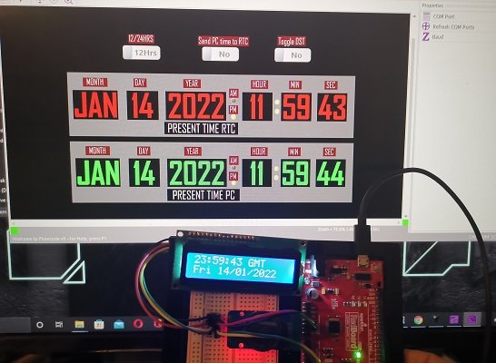

Wiring is very simple if you have the Backpack LCD as with that and the RTC SDA is A4 and SCL is A5.
If you have a standard LCD then you will need to change the flowchart accordingly.
Attached are all the required files.
An image of the RTC working:

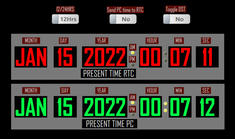

A screenshot of the App developer programmer:
as you can see the App developer shows both the RTC time and PC time.
Yes, I decided to base the looks on the time circuits of the Back To The Future Time machine.
Note the SetDay macro is set for Sat = 1.
It's not used within the firmware but set so you can use the RTC module within your own firmware.

I have included xLoader, so you can use that to send the hex file to the Uno/RedBoard.
I will be creating a hex file with the standard LCD so even if you have not got the component's license, you can still have a working RTC programmer

I'd be tempted to add 1s on the Arduino (or some 'better' synchronisation - so that the times match exactly) - then we are all set for some relativity experimentation with a little help from Mr Bezos, Musk or Branson?
I like that display.....

Thanks, Martin
I like the display as well.
That was my first attempt to jump back in the past about 500ms as that is the total difference.
I will inform the trio when the time jump works
