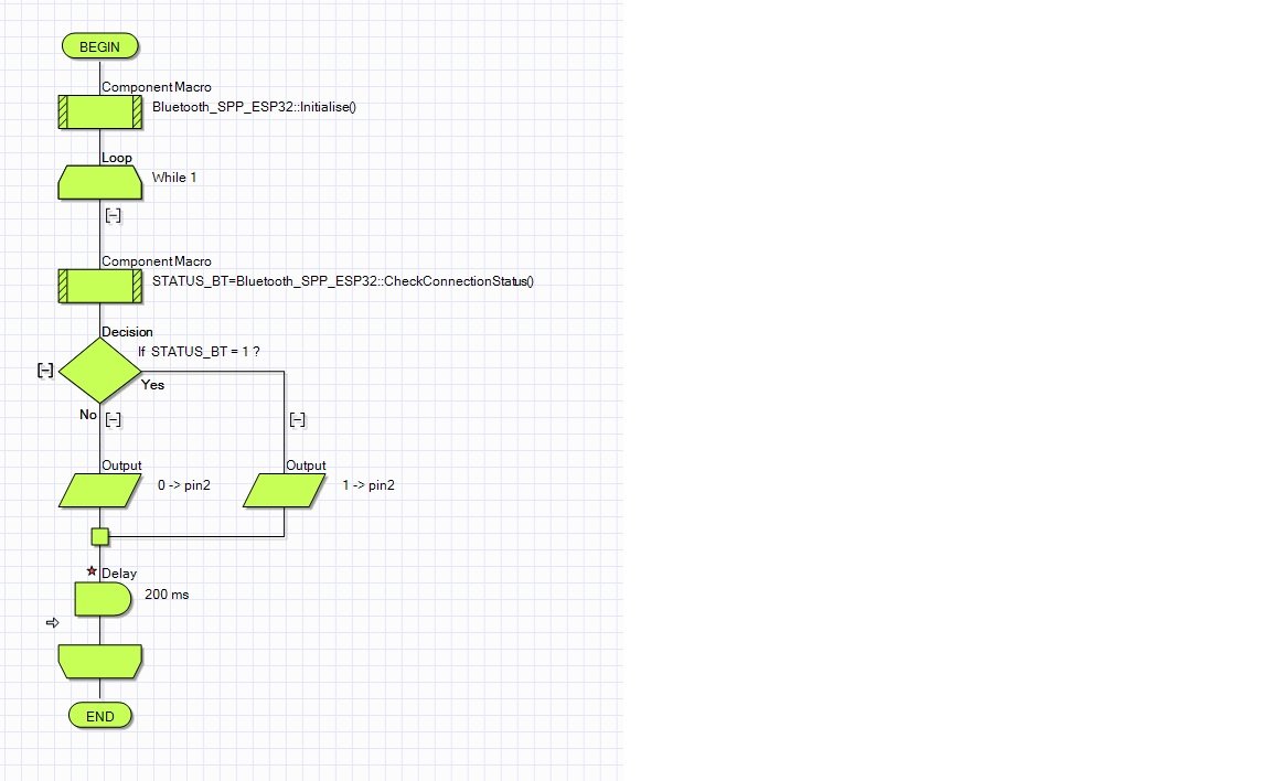

Hello again, I changed sdkconfig file from my project and now the compiler doesn't show the mistake, so now the code seems correct.
However if try to test the example doesn't work.
My example is very simple, attach file.
You can see in my example, only initialise module BT and check status only. If status is connected led pin 2 (ON), if not connected led pin 2 (OFF)
Very easy but doesn't work.
Thanks and regards.
Thanks and regards.
- EASY_CHECK_BT_ESP32.jpg (70.19 KiB) Viewed 56452 times

It might be worth trying to change the target device in the Project Options, then save the project with a new name and this will do a full re-compile for you and hopefully work ok with a different target device setup. I tested the Bluetooth SPP here and it works very well so hopefully it's still due to a config issue with the devkit.
