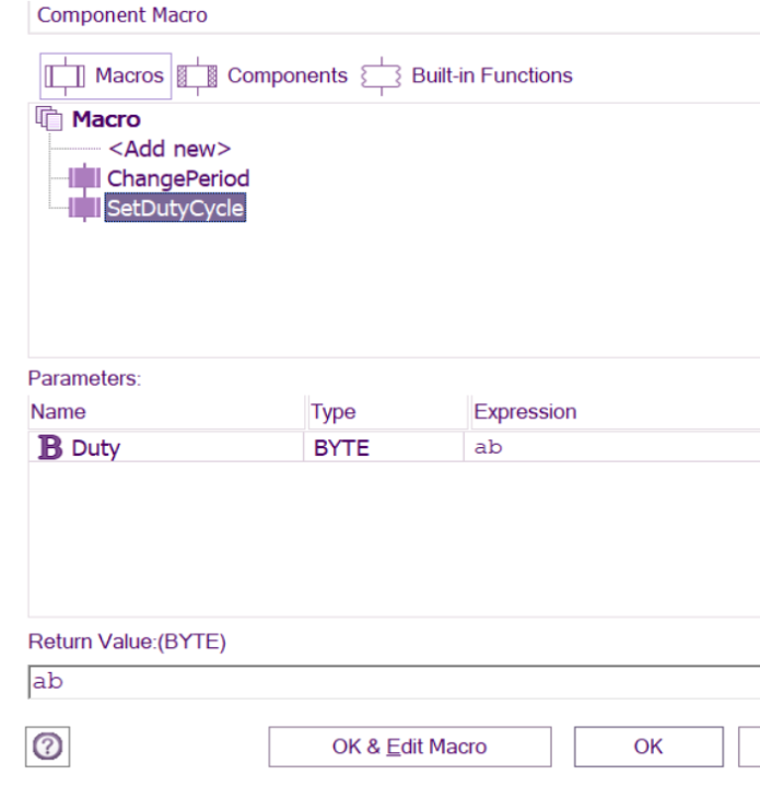

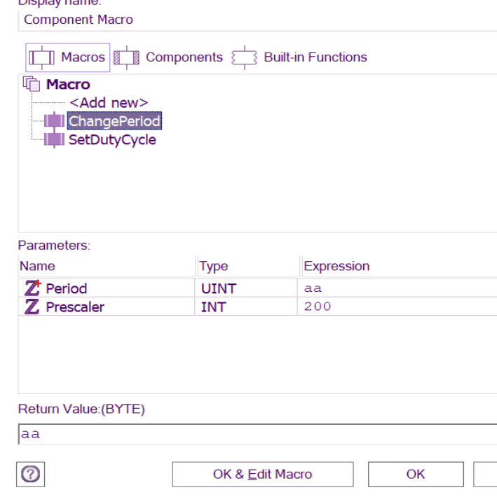

Now I managed to open the file PWM2.c

// Name: Delay, Type: Delay: 250 ms
FCI_DELAYBYTE_MS(250);
// Name: Component Macro, Type: Component Macro: PWM1::Enable()
FCD_0df41_PWM1__Enable();
// Name: Component Macro, Type: Component Macro: PWM1::SetDutyCycle(ab)
FCD_0df41_PWM1__SetDutyCycle(FCV_AB);
// Name: Delay, Type: Delay: 180 ms
FCI_DELAYBYTE_MS(180);
// Name: Component Macro, Type: Component Macro: PWM1::ChangePeriod(aa, bb)
FCD_0df41_PWM1__ChangePeriod(FCV_AA, FCV_BB);
// Name: Component Macro, Type: Component Macro: PWM1::Disable()
FCD_0df41_PWM1__Disable();
mainendloop: goto mainendloop;

Sorry, just now I set the return variables as you said, but it's still not uploading. What shall I do ?
Felix
Felix
- b2.png (84.53 KiB) Viewed 5536 times
- b1.png (91.48 KiB) Viewed 5536 times

In your project PWM2.fcfx
in the main macro, you never call ChangePeriod or SetDutyCycle macros
so you might as well delete them
that will remove the build error
Otherwise, edit or create the ChangePeriod or SetDutyCycle macros without a return value
ps. please learn to use the Attachments -> Add file
