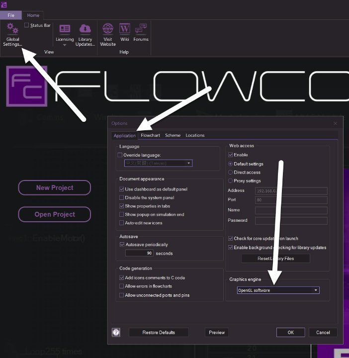

Can you trie this? Set it to OpenGL software.

It makes no difference if it is Open GL Hardware or Software and it only seems to be with the 2d panel, even in a new project without anything in it.
