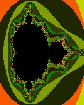

A little weekend project - the world's smallest (probably) Mandelbrot set plotter..
I used an ESP32 with a ST7735 display (any display should work - the only requirement is for a plot x,y function). As an interesting benchmark it might be fun to try some different MCUs?
Here it plots a Mandelbrot set in random colours - clears the WDT and repeats (the scope for zooming is limited with 32bit floats - but with a touch screen would be a nice addition?)
I used my own display code - if you use another display then you just need Iter and Mandelbrot (and MAX_ITERATIONS and colours) (+FeedTheDog to clear the watchdog timer...)

Re: Mandelbrot Set generator
Excellent work there many thanks for sharing.
With a little fiddling and adding the GLCD base component I've got it running nicely in the sim.
Post by mnfisher »
Cool - how does performance compare to an ESP32??
Should also be possible to work with a higher resolution?
