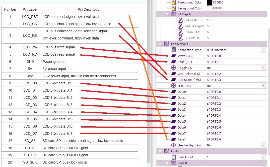

There are 5 pins to deal with data/clock etc in serial mode but the fc module uses a 6th Dataport_low defaulting to C.0 Where does it get connected?
Its the same layout as below http://www.lcdwiki.com/2.4inch_Arduino_Display
Pointers much appreciated

The information you linked to states Module Interface 8-bit parallel interface
I don't think you will be able to use these displays in SPI mode.
How about this for the parrallel connections..
If you also want to use the SD card socket then you can link the SD card / FAT component to the four SD_ connections.
I'm not seeing any touch connections which is odd as it says it has touch capability and shows a stylus.

Thanks Ben. I did think I would need to use a full port for the data. Kind of limits the capabilities of any circuit i put it in but should work pretty fast. I'll give it a go over the next couple of days and get back
