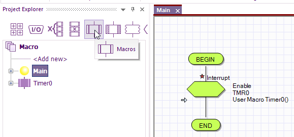

Until a fix is released, there is no need to shut FC down.
The new macro will always appear in View, Project Explorer, Macros
Interrupt Macros.png (22.55 KiB) Viewed 7558 times

Re: Create new macro from interrupt
Although it's fixed, it won't be available until the next update is released.
That is the reason I mentioned the Project Explorer. :)
