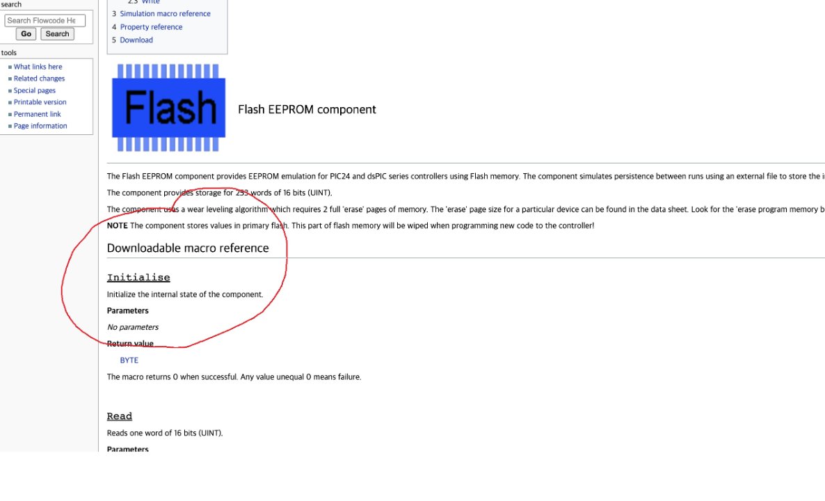

And the FlashEEPROM component does not have the Initialise property in the attached picture. Will this work without it?
https://www.flowcode.co.uk/wiki/index.p ... _component
- Initialise.jpg (70.83 KiB) Viewed 4678 times
