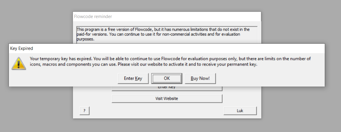

Then I would perform a test whith these devices in the FC5 to see if this would work, but suddently when I try to open FC5, I get the meaasage " my licence has expired?
It is not possible renew, also here no matter what I do. Can this be fixed, I have many project made in Fc5 Do I have to pay for FC5 again????

- Key.PNG (88.74 KiB) Viewed 4150 times

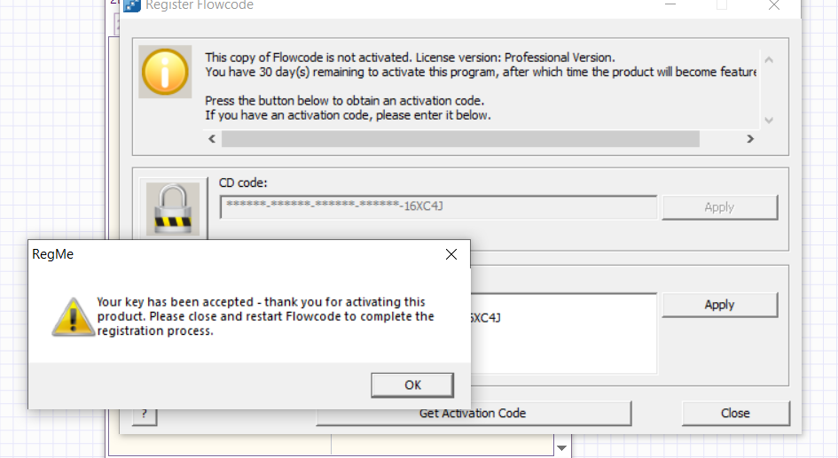

Concerning activating I actually have two Key´s. My private and one for my job.
When I try to activate for my private, Wrong username or key. And when I try to look in "Legacy Products, then select View old licences" Nothing is there, so if you can I will be glad if you are able to add it there
If I use the license for my job, FC5 accept it, but after restart it is not activating?

- Accepted.PNG (131.43 KiB) Viewed 4131 times

Hi Jorgen.
It looks like the correct CD code is being used.
The Activation Code is wrong as it looks like you are using the same code as you did for CD.
For the activation code:
Do you still have that code?
The requirement is seven sets of six characters separated by hyphens.
