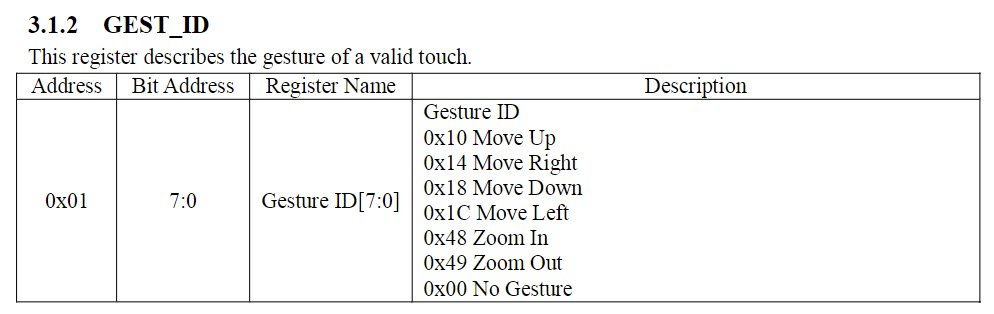

gesture

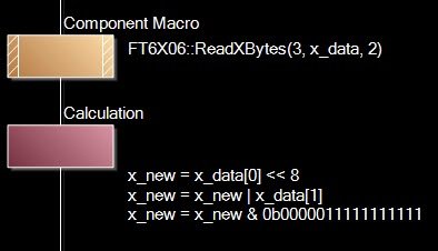

I've now exposed the Read and Write bytes macros for you that allows you to read and write the register values.

I've read the gesture register but this is always 00. I've googled and many have problems with it. I keep looking.
I also read the X position and this is a maximum of 320 pixels and independent of the component x size propertie.
X_new code:
