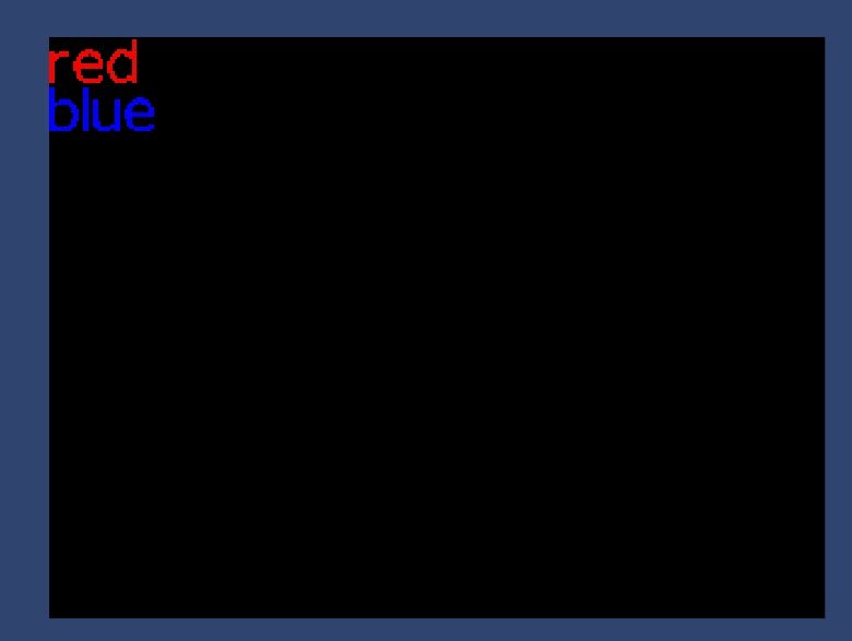

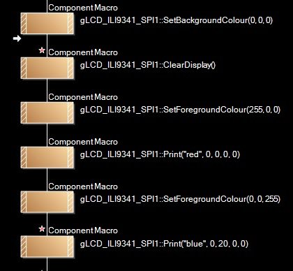

- How can I with, for instance the ILI9341 macro use multiple colours on the display? I see only parameters in the component macro for foreground/background colours. How can I print several things in different colours?

Here a info about the color. Its working also in the simulation
Just set the front color before you print a text, line or circle.
Demo:
