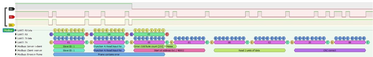

Here is the logic analyser showing the whole message being sent but the direction changes after the function byte.

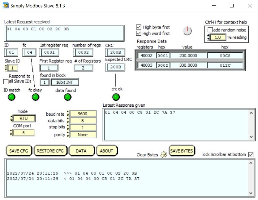

Here is the slave showing the whole message received and a simulated response.

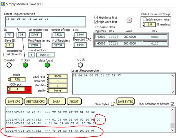

Update, in my test with the software slave it appears to work but something strange is happening now.
The message is sent as expected but there is an extra byte on the end (circled), then there is also another request that I have no idea where that is coming from. This is happening on evert message where it did not before?
