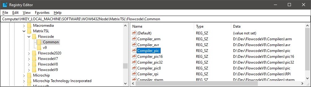

Hello Jan,
Nothing else should be required. Do you have anything that's blocking writes to your registry?
Are you familiar with Regedit? If you are then you can check this location and see if there is data there for the Compiler_pic.
Computer\HKEY_LOCAL_MACHINE\SOFTWARE\WOW6432Node\MatrixTSL\Flowcode\Common
Take care not to edit or delete anything else with Regedit as this can mess up your OS.
Here's how mine looks.

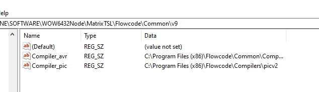

Hi Ben, thanks for chiming in.
They are there but not under Common but rather under Common>V9.
I did not change any of the default folder locations during install.
Jan
Jan

Re: PIC 8bit toolchain nor gecognized
Hi Jan.
\Common\V9 is correct.
What is not correct is the path.
You have got
Whereas it should be
If you double-click on Compiler_pic in the right-hand window you can change the path.
What does the path show Global Settings (Via view menu), Locations Tab?
It should match the registry path for pic.
You could also check that the picv2 folder is indeed
just so everything matches.
You have got
C:\Program Files (x86)\Flowcode\Compilers\picv2Code: Select all
C:\Program Files (x86)\Flowcode\Common\Compilers\picv2What does the path show Global Settings (Via view menu), Locations Tab?
C:\Program Files (x86)\Flowcode\Common\CompilersMartin
