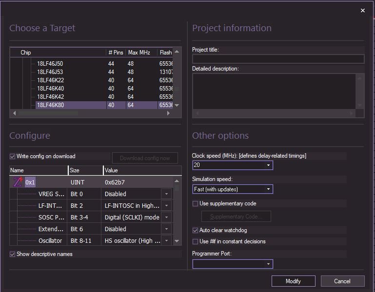

If i compile to hex it complies and yes i am using a PIC18LF46K80 and a pickit3 programmer. I have checked in MPLABX and the programmer is working and can read the chip on the board
What i have noticed is that in program options there is no program ports which is strange as i can read the programmer in MPLABX
Program options.JPG (69.23 KiB) Viewed 9050 times

Iirc mplabx and the command line programmer require different firmware in the pickit, however you are not getting to that point yet.
Looking at the output the settings for the programmer are wrong for this version of the MPLA’s software. What are the settings in FC for the programmer? (Not compiler or linker)
