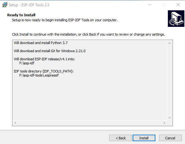

Thanks for the reply I have followed the flowcode esp32 tool chain installation many times with no luck the one thing i have noticed is that when you get ready to install section my files are loaded in different directory
My installation

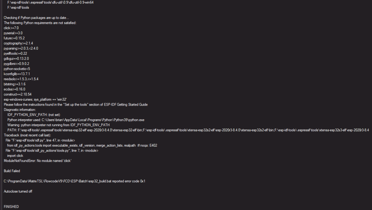

The message I'm getting now when compiling and I've set the global settings location for the esp to F:\esp-idf
Compile 2.png (206.56 KiB) Viewed 15714 times

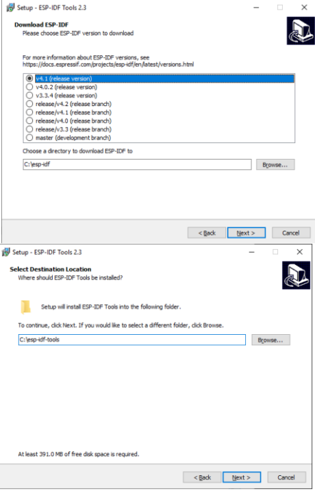

Hi Brian,
Before installing, if deleted the folders you get the option to enter the path on the next install:
Setting up Paths.png (107.84 KiB) Viewed 15697 times

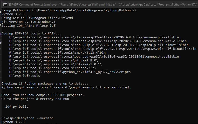

Could you run the "ESP-IDF Command Prompt" (not standard Cmd Prompt)
this should be on your desktop.
See if any errors are reported.
Then type
python --version
and see if Python runs and reports same version.

I have done that and everything is right
python version.png (48.55 KiB) Viewed 15682 times
I'm really at a Los as I have done everything according to the installation instructions.

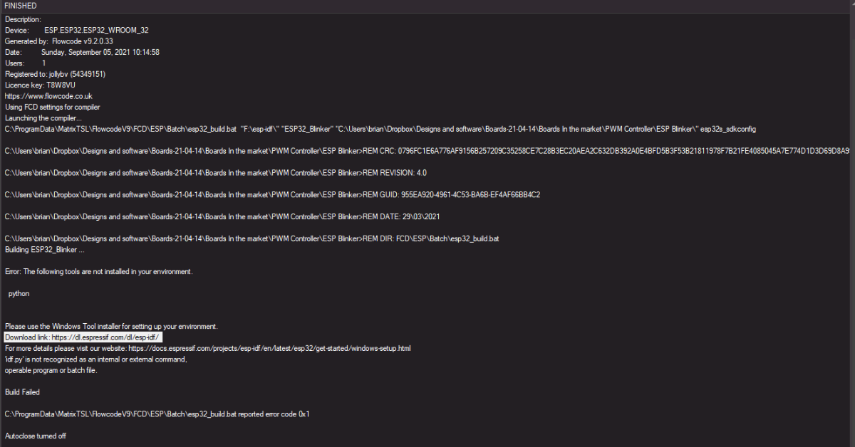

Its still the same telling me that i don't have python installed
compiler message.png (238.38 KiB) Viewed 15680 times
ESP32_Blinker.msg.txt
(2.53 KiB) Downloaded 871 times

Tha's very strange, is Python installed on a different hard drive? Might be worth checking that the Python executable is on your windows path just in case this is causing problems.
https://www.architectryan.com/2018/03/1 ... indows-10/

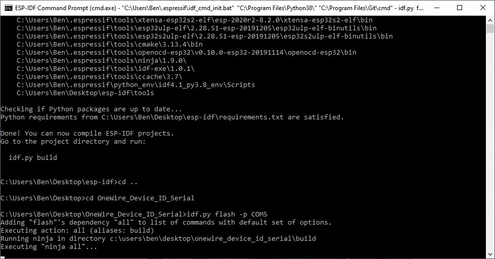

You can also maybe try launching the compilation from the ESP-IDF Command Prompt and see if this works or reports the same error. Just navigate to your project directory and then into the build folder created by Flowcode then type in the following command to compile and program. Change COM5 for your COM port.
idf.py flash -p COM5
As a last resort maybe try re-installing the idf but using the Python it packages with it. This includes things ike PySerial and other none standard libraries so maybe will include anything your currently potentially missing.
