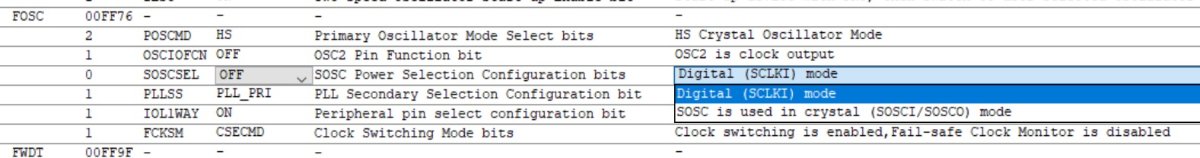

I found the cause of the error.
In the configuration bits setting, the second oscillator input wasn't defined as a digital input (SOSCSEL bit).
I use this pin as the input to the receive side of the UART.
I think the function description of this bit is not clear in the Configure block of the Project Options menu.
The description of the function assigned to the MBLABX "SOSCSEL" bit is clearer.
Regards,
