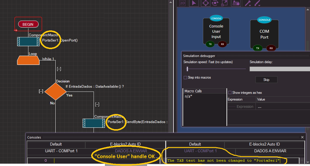

Hello FC9 Users.
In the COM PORT component, the original HANDLE is “UART-COMPort1”.
But if we try to modify it to “PortaSer1” for example, it isn’t correctly recorded on the “Console User Input” TAB, continuing display the original name. Is this the normal behavior ? :?:
Thanks for any tip.

Thanks for letting us know, I've hopefully sorted for you now via the help -> library updates.
I've now changed the console name so it should show the component name and then the COM port number.
e.g. PortaSer1 - COM10

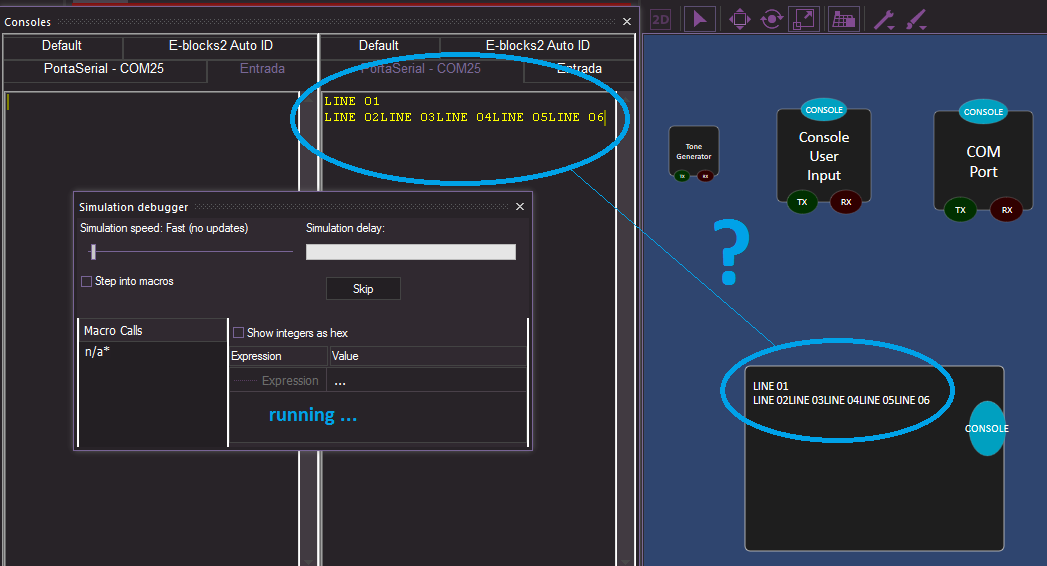

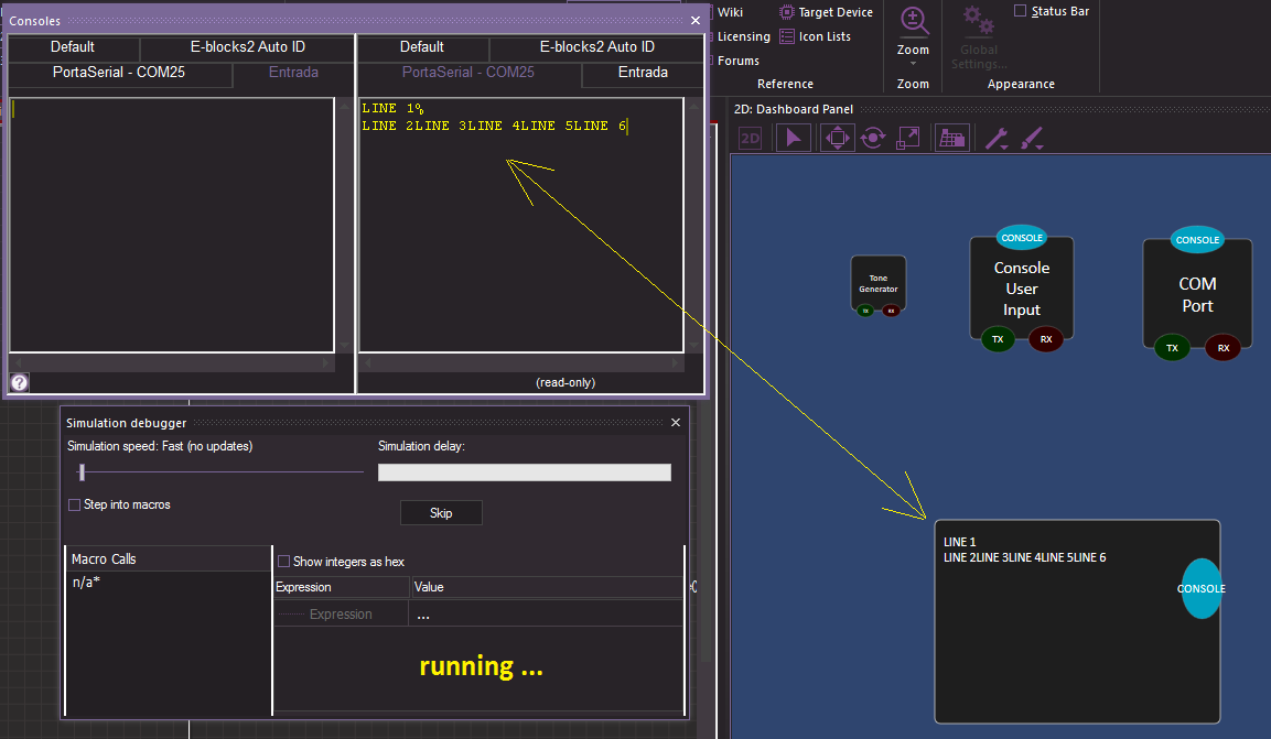

But there is still a doubt. Why after the transmission of the console´s five lines to COM Port only line 2 jumped, and the others continued on the same line ? :?

Thanks for letting us know. I've added a new property to the COM port component now that checks the type of new line being sent. This should hopefully now catch and process the \n line feed correctly for you.

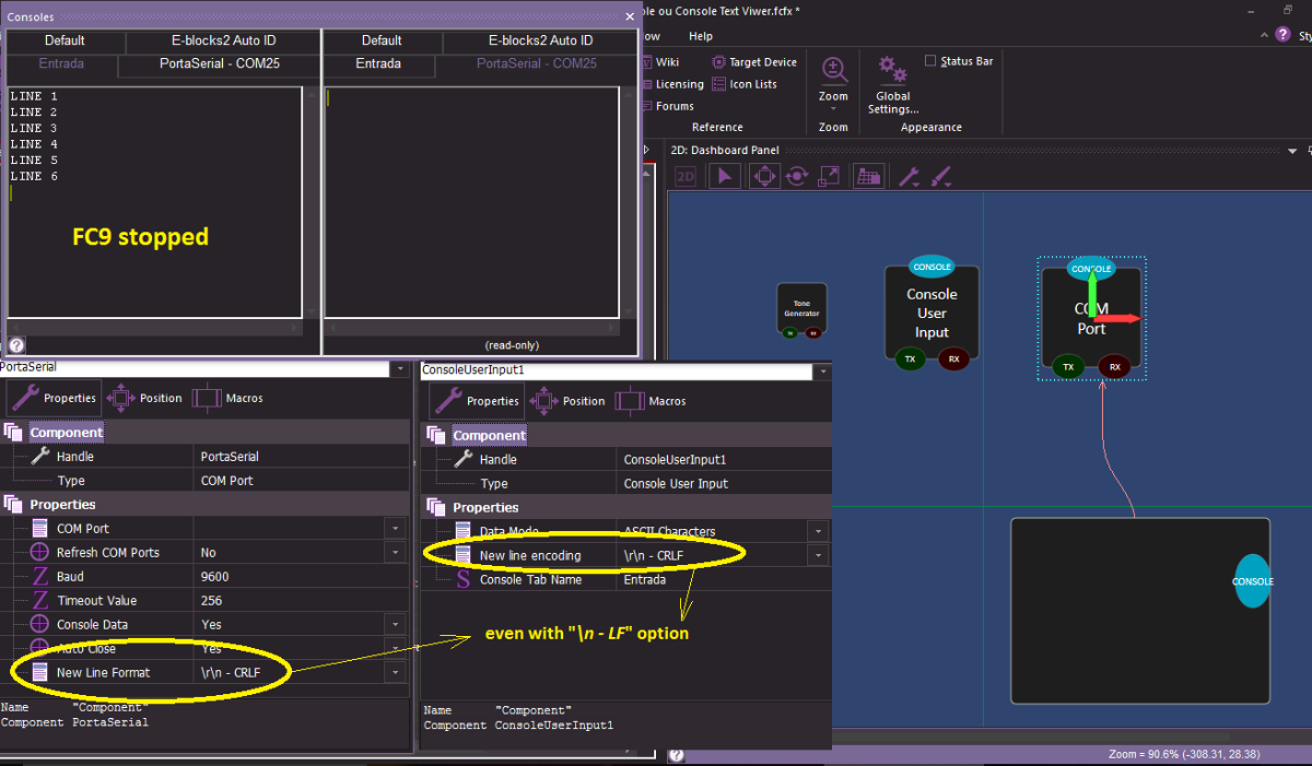

Hi Ben. Thank you for your answer, but it wasn´t this time.
I dealt with two notebooks with FC9. Even trying with the two line feed options in "Console" and "COM Port", after RUN the lines are positioning themselves on the second line only. :(
