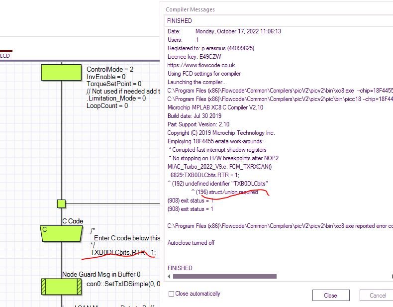

Dear Team,
I tried as a work around to set the RTR bit manually however it seems the TXBnDLC register are not in the definition file.
Thanks again for your help.

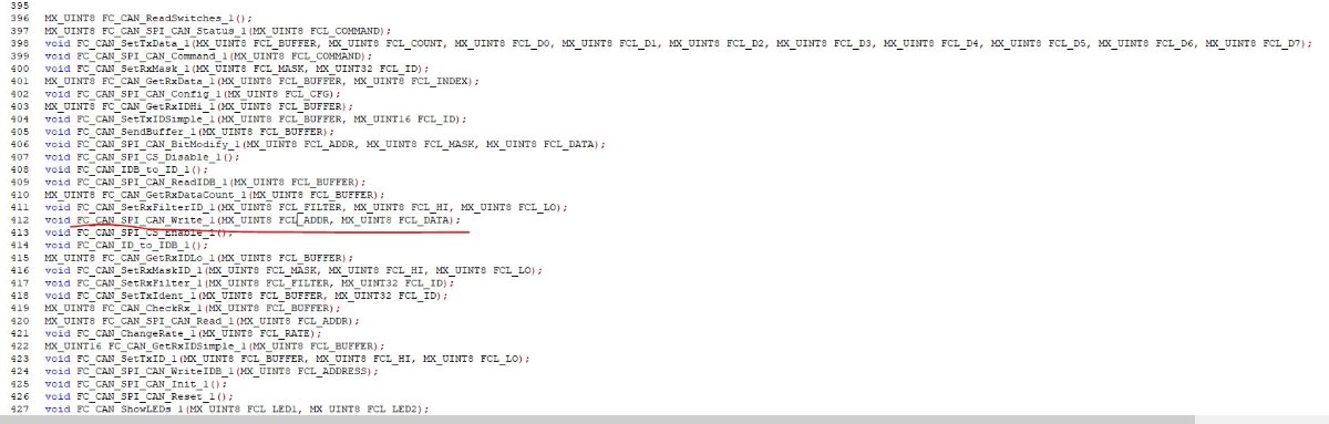

Hi Steve,
I understand this Thank you so much.
I could only find the following in my C Code it seems your suggestion is correct with " FC_CAN_SPI_CAN_Write_1" Please just check for with your experienced eyes
