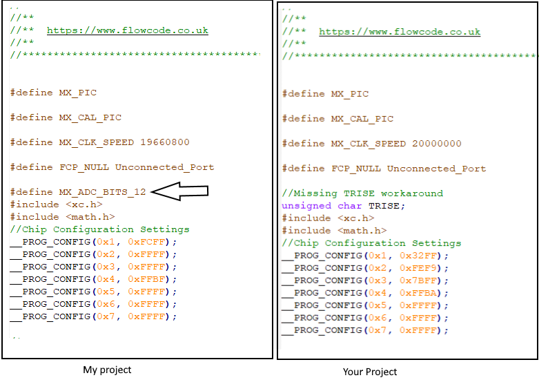

I have attached an image of what your C code looks like and what it should look like if the file attached in my above post is used:
Project Comparisons.png (122.69 KiB) Viewed 10094 times
The arrow is showing the line that must be present for the 12bit ADC to work.
Can you please confirm the full path of the folder you placed the file?
Are you using a 64 or 32-bit PC?
