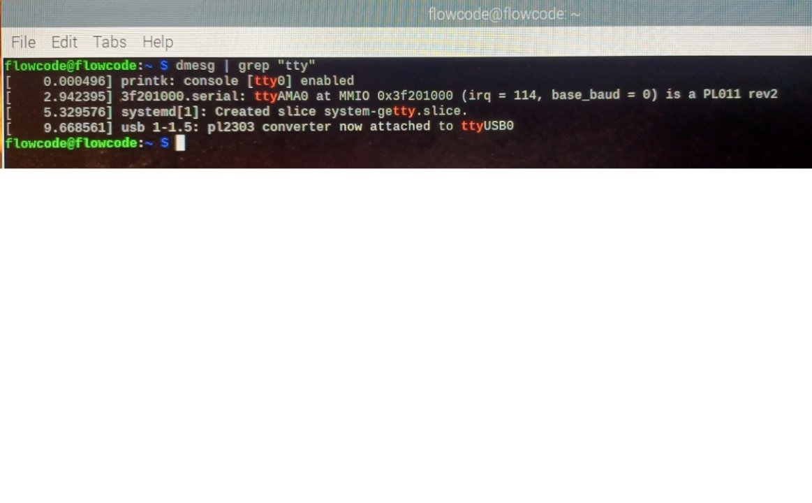

This is the info on the pi showing the device is attached to ttyusb0.
Pi info.jpg (66.56 KiB) Viewed 4313 times
Is there a way I can confirm the symlink is correct?

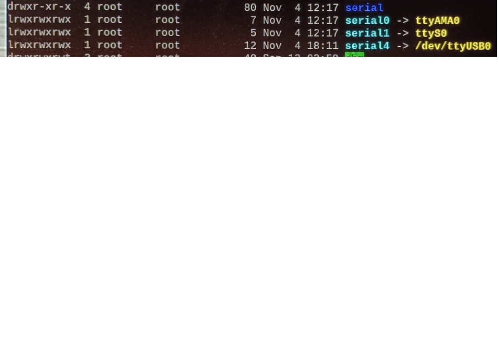

I changed to serial4 and it works, reboot the pi and it does not and when I check the liknk is no longer there.
I found this command ls -l /dev which shows the link for serial4.
What I need to find out now is how to make the symlink non volatile, I wonder if it can be placed in the config.txt file?

Adding the symlink ln -s /dev/ttyUSB0 /dev/serial4 (in my case) to /etc/rc.local appears to work.
