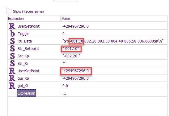

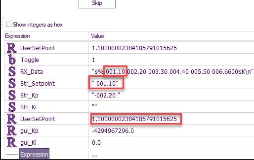

I am reading in a string on the UART then I split the stings and take out the different strings and then convert the strings into float numbers
my problem is when the substring is a positive value it converts correctly however when the string contains a negative then it converts incorrect
example "001.10" Convert correctly as below
Here we can see the same sting now negative "-001.10" results in -429496xxx
What am I doing wrong :oops: The String RX_Data contains the string send by the instrument I am communicating with .RX_Data is declared as an String in FC.

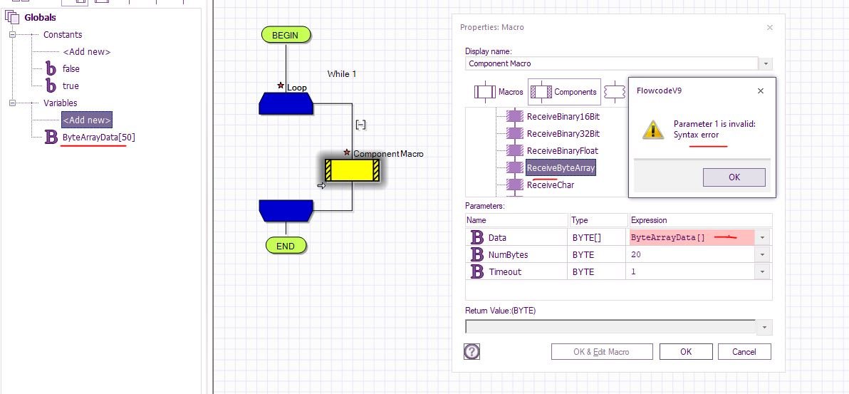

I am also a bit confused in using that receive ByteArray macro from the UART component, I delare a byte array when I sue it in the macro parameters it generates an error as below Also here what am I doing wrong :oops:
Appreciate all help pointers as always :)

Just pass:
ByteArrayData (not ByteArrayData[])
How are you converting the string top a float - seems correct in simulation using StringToFloat$() - am I alone in thinking some of these functions are misnamed - should be StringToFloat and FloatToString$)
p.erasmus
Posts: 434
Location: Russia / Россия
Has thanked: 104 times
Been thanked: 88 times
Re: String Conversion Issues
Post by p.erasmus »
Thanks Martin will give it a try ,
These are the functions I am using FloatToString$)
