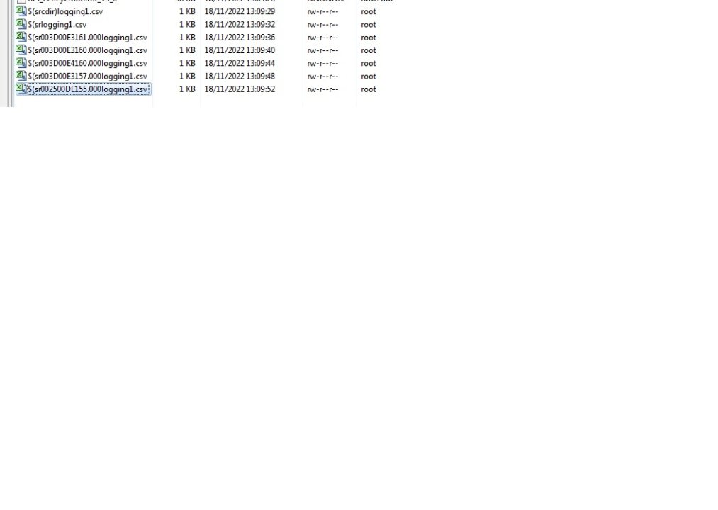

I have now managed to get the CSV writer to work (sort of) on the Raspberry pi, the problem is that it does not append but creates a new file for each write.
This is what I am getting, the first file has the header texts and then each at 4 seconds apart has one row without the header.

I think it doesn't like the Root Folder being $(srcdir) as this is a Flowcode simulation thing. In the File_RPI1 change the Root Folder to a blank string and hopefully that should fix the problem for you and place the files with the runtime script into the home directory.
Keep the Sim root folder property as $(scrdir) to allow the simulation to put the files in the right place.

Thanks that worked. I thought when i tried it like that originally it did not create a file at all?
