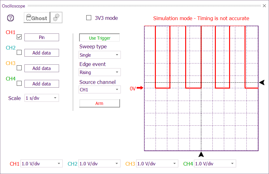

On the oscilloscope click 'use trigger' then click 'arm'
First time of running - nothing happens - trigger doesn't fire. Changing anything (dragging the 0V marker down for example) - causes the trigger to fire and all subsequent 'arming' works AOK. It then works perfectly until FC is shutdown and the program is reloaded.

I've looked into this and I think it is working correctly. But the way the triggering works is perhaps not explained very well in the wiki. I will try to explain a bit more here:
Without the trigger, you should see the waveform when the simulation is run. With the trigger, the waveform will show only when trigger condition is fulfilled.
When your project loads, the 0V setting of that trace is set to the middle of the vertical scale. The trigger-point is also set to the middle of the vertical scale (as well as the centre of the horizontal scale) as shown by the two arrows. The "sweep type" is set to "single", the "edge event" is "rising", and the "source channel" is "CH1".
Clicking "use trigger" and then "arm" will make the oscilloscope wait until the trigger condition is fulfilled. This will occur when the oscilloscope detects a rising edge in the centre of the vertical axis. But this is currently not happening. The waveform is oscillating between the "0V" position of the trace and the "5V" position of the trace, but there is no rising edge happening at the centre point. If you move the trigger point down or the 0V marker for the trace up, then the rising edge will be detected and the waveform will be shown.

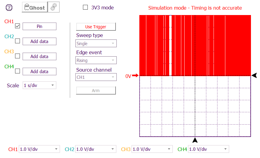

  6. Drag the black arrow up so the trigger point is within the range of the trace and the trace is shown. It is in "single sweep" mode so the trace remains and you would need to press "arm" again to reactivate the trigger.
    osc triggered.png (42.11 KiB) Viewed 7049 times
I don't know why your oscilloscope is disappearing - that is odd.

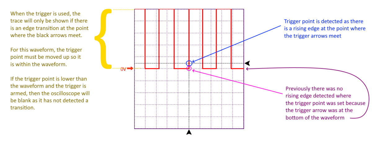

Regarding the trigger point position, I've tried to explain things a bit clearer in the following diagram for the benefit of anyone else having issues with the triggering on the oscilloscope.
osc trigger explanation.png (199.49 KiB) Viewed 7049 times
I think some of the initial confusion could be because when the project is first loaded, the trigger point is at the same position as the low point of the waveform and at this point the rising edge is not seen (it is only seen when the trigger point is above the low point, and not equal to it). I have experimented with this and changed it so that in v10 the edge transitions will also be detected at the high and low points of the trace.
