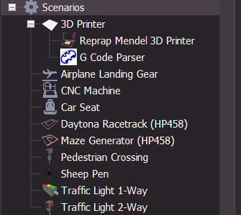

Re: Flowcode and CNC Machine Component
Yes perfect. It's moving again.
The CNC machine is really nicely made.
But I can't find the components in FC App Developer.
Are there mechatronics and scenarios for the FC App Developer?
Not In FC App Developer

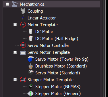

- Posts: 2242
- Has thanked: 616 times
- Been thanked: 815 times
The CNC and some other scenarios require stepper motors to move the various components around on the panel and the stepper motors require pins for movements. I'll have a think on if there is a nice way to replicate this for app developer. Maybe some sort of X,Y,Z, translator component?

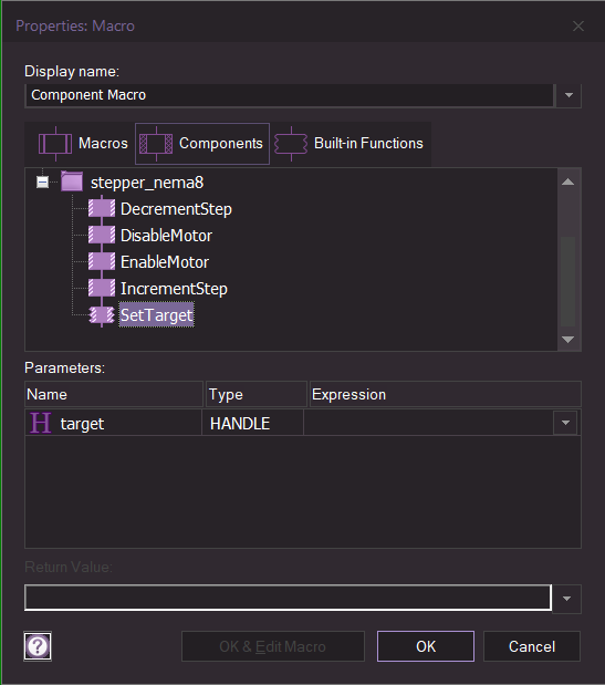

- Posts: 1264
- Has thanked: 234 times
- Been thanked: 252 times
I have a few suggestions and wishes
the first would be:
The Stepper_nema8 for FC App developer.
With the target handle I can just put the motor pulley over the stepper axis and select shape1 as target
The pulley will turn like the stepper.
imported motor pulley
the first would be:
